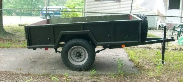

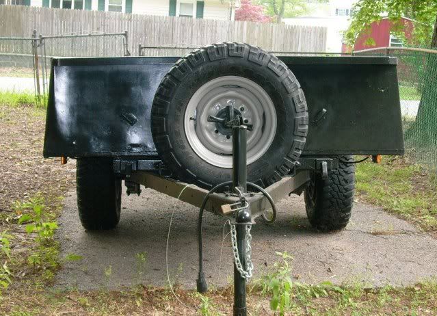

Originally Posted by RKBA View Post
Bringing this back from the dead.
I got my M101A2 down to 1000 lbs, the tongue is 100 lbs. and it's four inches lower due to a spring under conversion.
Here's what I did:
Removed surge actuator/lunette - replaced with regular old A frame ball coupler
Swapped adjustable front landing leg for standard trailer tongue jack
The rear cross member was badly damaged by Private Snuffy so I simply cut it out
Replaced military axle w/5200 lb electric brake standard trailer axle - it has 12x2 8 lug drums and EZ lube spindles
Added small electric brake breakaway battery
No shocks
I think you could get down about another hundred lbs by using a 3500 lb axle with 10" brakes and lighter 15" wheels/tires. My eight lug steelies with LT235/85R16 tires tip in at almost 80 lbs each.
Nice! Lets see some pics!
