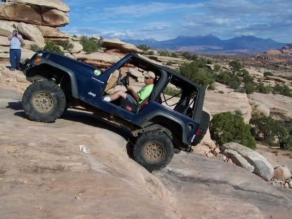

How much does my Jeep weigh?
I don't have access to a scale (that I know of). Here's a picture of my Jeep with 37s (five of them), the winch, bumpers, Atlas II, Ford 9", aluminum Dana 60, auto trans, and 4.0 engine. Can someone give me a round number of what they think this Jeep would weigh? I am looking for a new tow vehicle that will need to tow the Jeep inside a 3000 lb enclosed trailer.
Here it is:

I'd say your jeep+trailer would be 7-8000 pounds. Heavy estimate. A cummins would tow it no problem. A newer (within 3-4 years) half ton should be able to do it ok, but who doesn't want a cummins?

id say closer to the 8,000 mark with trailer, then you have to remember to add in all your gear, gas, people to total weight

Nice Jeep!
With a tow vehicle, right size is always large size. I've done a whole lot of towing over a long period of time, and I'll tell you that if you "right size" your tow vehicle you won't be happy. Go bigger than you need. And, go diesel. An F250 diesel is just perfect for towing. You don't need a dually or a long bed or a crew cab, so it will easy to drive and park. That's my $02.

I have a 98 with the 4.0, manual, 14bolt, d60, 36's on 17's (5 of them), arb front bumper, jeeperman rear, no top, with a full tank and no one in it it weighs 4800.
I know your setup is a bit different like i didnt have my winch mounted, no top , and a stick shift, but it may give you a ballpark of where you are.

Thanks. I would think your Jeep is pretty close to the same weight as mine. Your 14 bolt is heavier than my aluminum 60, and your 60 is heavier than my 9". But my Atlas II is heavier, and your Jeep didn't have the winch on when you weighed it. I'm thinking the auto vs manual transmission doesn't affect weight too much. 4800 lbs is about 300 lbs more than I was guessing it weighed.
I did find out that IFA (a farm supply place) has a scale, so maybe I can go down there and get an accurate weight.

And I highly doubt your Jeep is anywhere near 5000 lbs, my YJ is about 3500.
