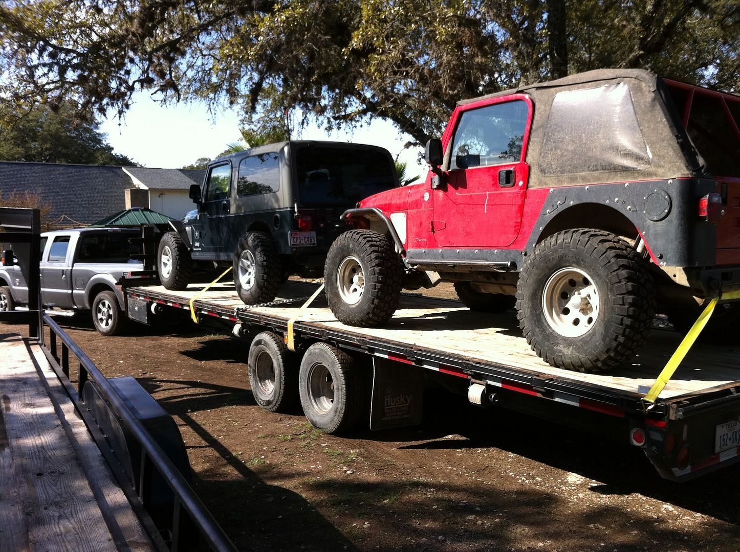

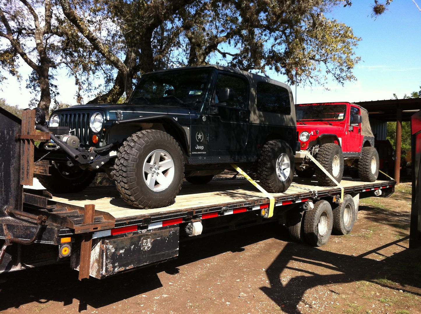

I tow pretty regularly with two rigs on a 26' flatbed.
While I understand the below is a Sami, it's fairly long. I've got another pic somewhere of my Jeep with a CJ8 on my trailer.
Here's a LONG wheelbase Toyota on my trailer. I didn't like how this was loaded, but for the 6-7 miles I towed it, it worked fine. My leveling kit on my Dodge isn't real towing friendly.

Uh, ????? Looks like it works well to me? The green CJ8 has been on that trailer for probably 2500 miles with my Jeep behind it. Towed by the blue Excursion or my black Dodge.
I think the Sami has about 115-118" wheelbase (meaning his Sami takes about the same "signature" on the trailer as my Jeep). The Toyota thing in the other picture is about 126"-128" wheelbase and is showing that as the limitation of the 26' trailer. I don't think I'd want to haul that one very far, but it worked for the 5-6 miles required.
USUALLY I only tow my Jeep around. 32' is kind of big for that. The 26' will take two when I need to but is still relatively manageable in parking lots at Wal Mart and the mall.

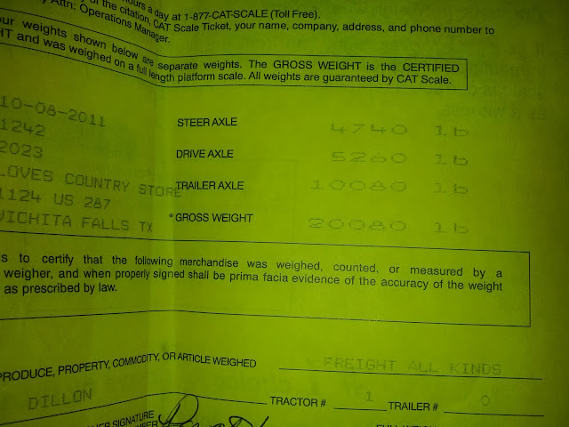

I know this is a month old, but I'm gonna throw in my 2 cents.
You are right. 29-30' is about the min you'll want to tow two Jeeps with. It can be done with shorter, but will take some extra work.
I tow 2 Jeeps, 1 YJ, 1 TJ on my 29' 14k GN trailer (25'+4' dove tail @ approx 5k unloaded) and can get them both on right at the 26' mark. When I weighed it in @ the local CAT scale I came in well below axle ratings as well. So I'd say what I have is about minimum what you'd want for 2 rigs.
Here are my weight tickets to show approx what 2 rigs will weigh:
Empty trailer:
Loaded:
Hope this helps anyone looking at this type setup.
