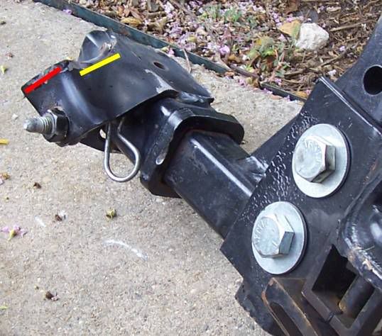

Here - I'll show you a few pictures of class IV hitch failures, just like mine that failed. These are pictures of two different hitches that failed, from a thread on RV.net where the group was discussing these types of failures. Wait - do they really exist?
Both were GM OEM hitches from the GMT 800 chassis, with the 5,000 lb weight carrying / 12,000 lb WD rating:
It's also interesting to note that these SAE standards were created to level the playing field between different manufacturers, by forcing them to test to the same specifications.

And how, exactly, do your photos of a crashed gooseneck trailer add to the discussion?
