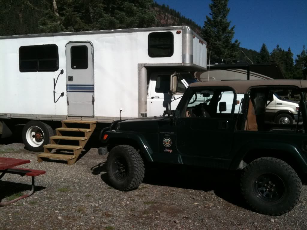

well I know this is very late but Here how it work on last years southern Ohio to Ouray Co trip.
I installed the door just a few days befor I left on the trip so i didn't get time to paint it.
Towing the Jeep on a trailer it averaged 10.5 MPG running at 65 on the way out west till i hit the mountain then it did drop to 9.5-to 10.0MPG.
It pulled the mountains just fine
Here it is in the campground
