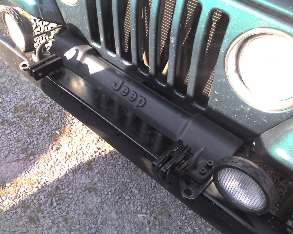

I pull a 98 TJ behind my class A Ford F53 chassis (more or less an F550). I'm running a Demco Excalibar tow bar and my own base plate. I didn't like Demco's and I didn't want to lessen my approach angle thus tearing up the attachment points, so I went over the bumper.
Between the 2+ inchs of lift on the jeep, my motorhome's low hitch height and that my base plate is above the bumper, I needed a 10" reciever lift to keep the tow bar level.

I finally got my 2002 Jeep Wrangler ready to flat tow behind my E450 class c motorhome. It tows fine without supp. brakes. I have a Demco Aluminator tow bar. I leave extra room in front of me anyways when driving the RV.
Got the tow bar used for $250 and a base plate for a toyota truck which I modified to mount on top of the Jeeps bumper.

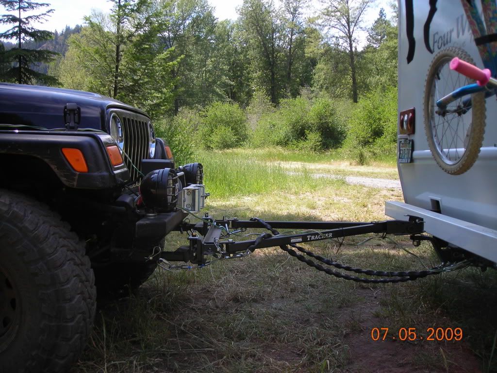

Roadmaster removeable frame mounts and entry level tow bar. Working great for almost 3 years.
