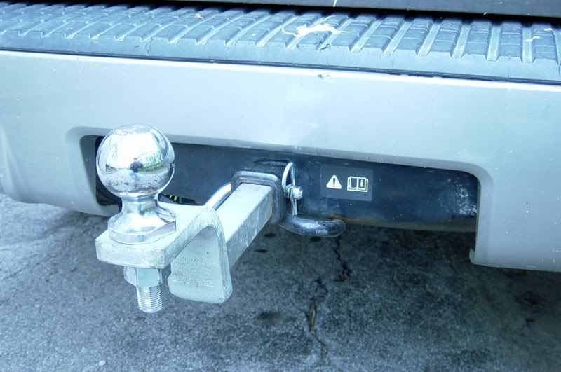

[IMG][/IMG]The mercury has a built in receiver that takes a 1.25 inch hitch

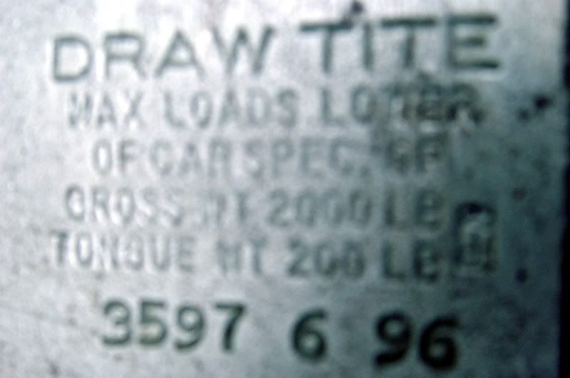

This is whats stamped on the 1.25 inch shaft
Gross weight is 2000 , Is that pulling and stopping force weight?
Is there no tounge weight if the Jeep is level as mine is?

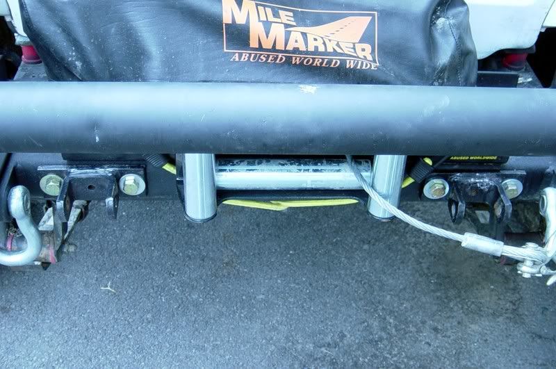

Tow bar brackets with grade 8 bolts

No, that is a class II hitch on your Mercury. It's rated to tow 2000 #'s MAX (stamped right on the ball mount). You need a class III or idealy a Class IV with weight distribution to do that safely in my opinion.
If something were to happen while you had that in tow, I would bet your insurance would not cover you once they saw that setup.

The receiver is built in from the factory .Its part of the rear cross member of the frame. How do I remove it and install a new one?

Contact Ford/Mercury, but with the low tow rating on that thing, I would guess there is a reason they factory install a really light tow hitch setup. You really don't have the weight to bring that contraption to a stop quick enough should an emergency come up. I think that Mercury is more for towing a fishing boat to a lake or a small pop-up camper, not a jeep with no brakes on it.

Ok, I found this:
http://www.etrailer.com/hitch-2002_M...ountaineer.htm
Looks like that rear crossmember stays in and you can bolt a new hitch right below it. Very silly, but thats the design I guess.
This is the theory, although the weight of that vehicle doesn't exactly make it ideal to flat tow anything.
You would need ideally:
New Class III Hitch Assembly
New Ballmount / Ball At proper raise / drop.
Auto Transmission Cooler (If you don't have one from the factory)
Lights for the Vehicle in Tow (Stop, Tail, Turn)
Bigger Chains than what comes with the Tow Bar Setup
Even with all this, my personal thoughts is I still wouldn't do it. Your YJ would push that thing around like a toy in any kind of abrupt maneuver or stopping. If you are doing this frequently, that makes the situation even worse.
