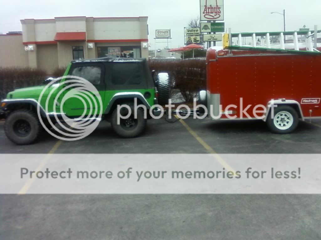

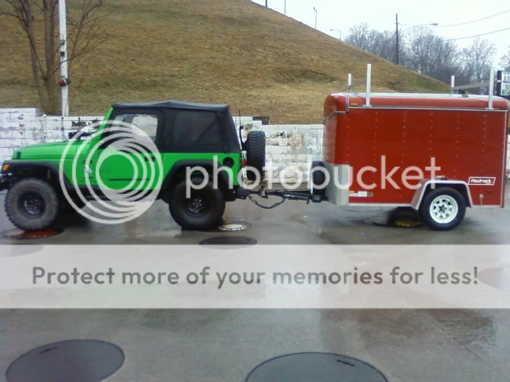

I've hauled different trailers. As far as the cargo trailer goes: Just simply don't drive stupid as well as don't expect gas mileage to be good, and you'll be fine.
I hauled my fathers 5x8 cargo trailer from Georgia to Lexington, KY on two seperate occasions(a five hour drive either way, four times total) through rain, snow, winds, etc. I also hauled the same trailer from Georgia to Aberdeen, NC once(ten hour drive either way, twice total). The ONLY thing I couldn't get used to was the third brake light, since the trailer is so close to the light, when you hit the brakes it lights up incredibly so(not blindingly bright, but still bright none the less). If the trailer is empty, due to the SWB you will bounce all over the place(still, not an uncontrollable bounce) and loaded down it pulls fine minus the hills.
I'm only 20 but I can't stress enough driving smart and safely. Don't ride anyone's ***, break WELL in advance, look everywhere at all times, check all your connections, tire pressure etc. constantly, be expecting the trailer to push you but once you get the feel of it you'll be fine, even talking to truckers helps alot. Also, do NOT, I repeat do NOT do anything but drive. If I've ever felt I needed to pay attention driving, pulling the cargo trailer loaded down is when you need to do it.
P.S.- I have a D35c, not regeared w/ 33x12x50 wrapped around steelies. I believe in Jeep!
