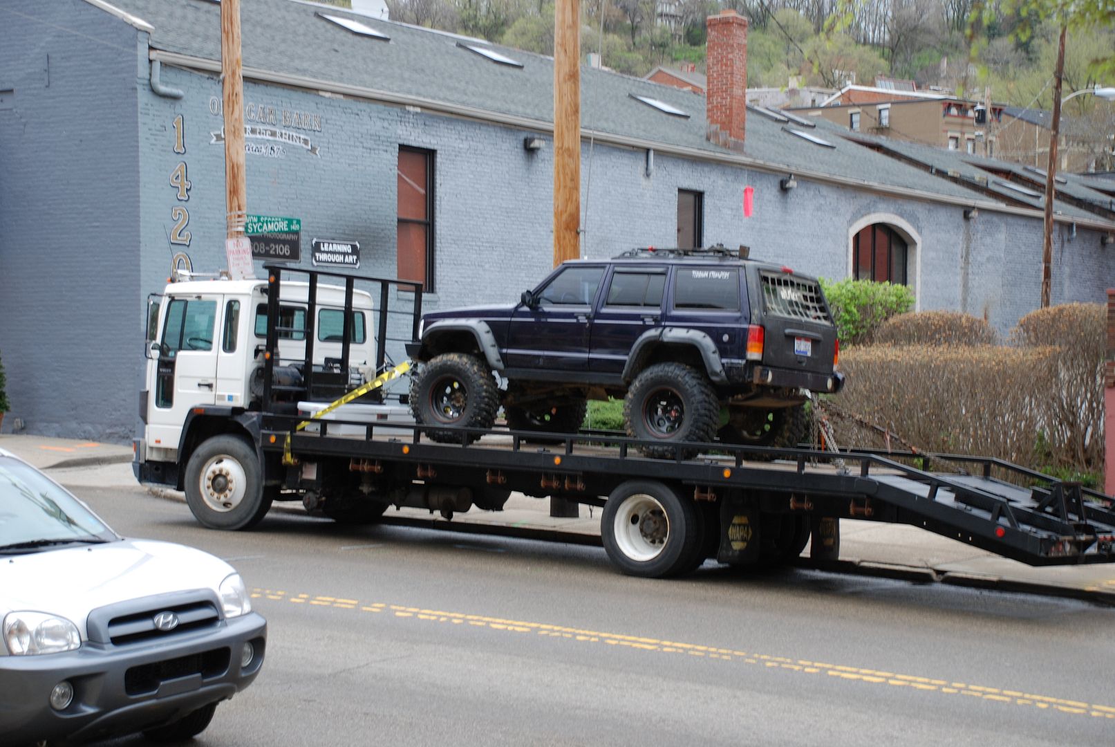

Well, here is my XJ secured to the deck of my Volvo tow rig: chains and binders from the Reese receiver to the welded on D shackles in the rear and cargo strap ratcheted to the D shackles on the Warn bumper in the front. I usually hook the winch hook into the headboard on the truck to snug things up a bit.
PS. Thanks for the comments about Cincinnati. Really is a great place to live. I can see the top of Kenwood Rd. hill from my house. There is a new senior living center up on the top of the hill. Very posh. Nice place to live if you have a big pile of money to burn. And, I am sure that you know that the Kenwood Towne Center is one of the top high grossing shopping malls in the US. Bring your black credit cards.
When I lived there it was pretty small, the Mall was the first of its kind though. Long gone though.
We went back there a few years ago to watch a Bears and Bengals game. I was amazed at how much it has grown.
Nice tow rig!
Where do you wheel?
Any close up pictures on how you tie your rig down?
I was surprised that I didn't have more of my XJ. I have a lot of photos of the Unimog on that rig, tied down the same way, but not any more of the XJ.
Everyone down here wheels at either Haspin, Badlands, Big Rock, etc.
The Volvo is pretty cool, huh? Has an air bag rear axle that drops the tail about a foot. Cat 3116, Allison 6 speed, full air brakes, a/c, winch on the headboard to pull up the dead rigs. OBA, tool boxes. Built at 33,000 GVWR. Carries two rigs like they aren't even on there.
