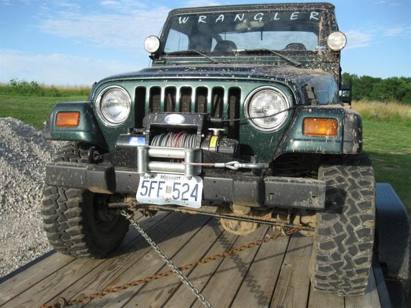

I like my way..Why? because it works for me and I've never had a problem. I use chains now but I'm gonna switch to straps. We use them everywhere else on farm, so they should work for my jeep.

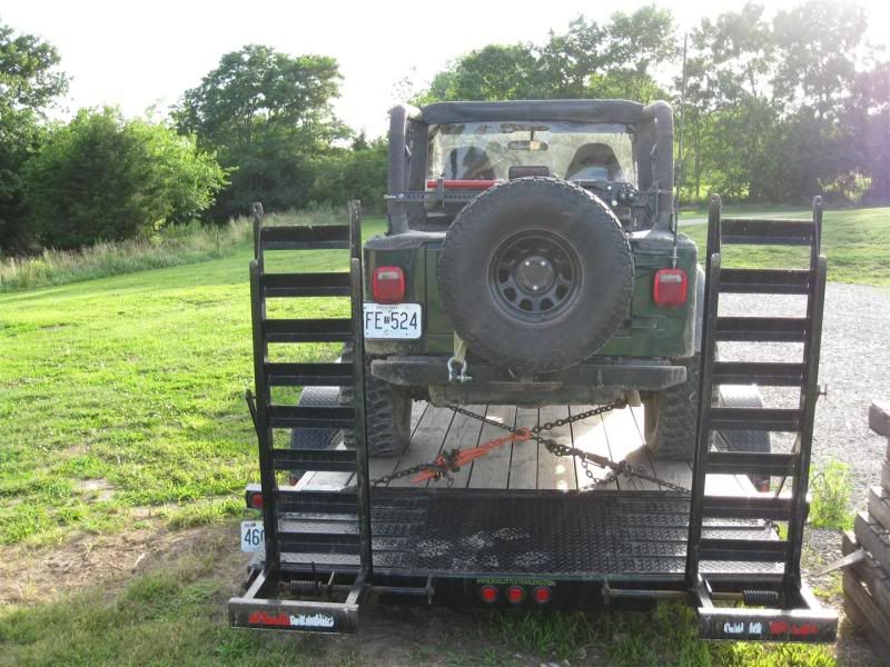

I use 2 chains for the front axle and one long chain for the rear. I find the most important thing is to load the rig over the trailer axles so that its balanced. Worked well for me over the years.
