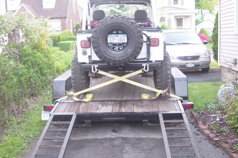

I have this front and rear
and chaines ( not pictured ) going from the side of the trailer up over the leaf springs to the other side on the front and rear

I know it's been mentioned, that crossing the straps/chains is the preferred method, but I'd like to know why. In playing around with linkages, it seems that long, crossed links allow more movement. In the above photo, it would seem that the crossed straps would allow far more "roll" (like an airplane) than straight straps to adjacent corners.
I'm not trying to advocate either method right now, I'd just like to know if there is some reasoning for it... Aside from using up as much of the strap as possible...

Great question. I don't like ratchet straps and I don't crisscross them when I use them. So, maybe I should just keep my mouth shut. But, that's no fun so here goes.
The angle on a crossed strap is flatter, or more acute than a strap that is attached directly below the D ring. Therefore, the ratchet can deliver more compression to the spring because each rotation of the ratchet lowers the rig less than if the angle was greater.

You may find that for some reason or another a crossed pattern is slightly better. I'll leave that to the engineers in the group. What I will say is, do not cross nylon or polyester straps. They rub on each other generating significant heat and basically just destroy each other. More so if you hook to the frame as opposed to the axle. If you want them crossed use chain. The straps are nice, light weight, easy to use. You have to baby them though and they will not last. Straps are for those with more money than patience.

That would seem a valid point for ratchets, but not for chain binders - a 10-year-old girl can lift a Jeep with a chain binder, can't she?
